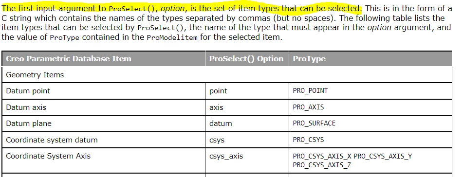

Nov 8, 2022 11:00 PM UTC
the first argument to ProSelect() function is a 'run-time' selection filter.
Nov 9, 2022 6:17 AM UTC
Thanks.
I think I was not specific enough. I intended to say without using function ProSelection.
Now I think that the filter in the lower right of the status bar does not anything but just serves as parameter to be applied for the above function.
FV_01
Nov 9, 2022 6:18 PM UTC
are you trying to use  ProSelbufferSelectionsGet(...) function?
