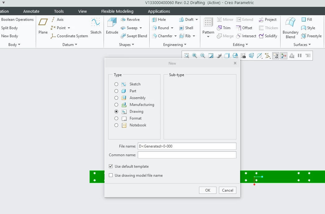

I need to create a mapkey to create the name of 2D drawing based on the 3D part but adding some extra strings on it for example,
If the 3D part name is V132000430010, then when I call the mapkey it will create a 2D drawing named DV1320004300100-000
that means I need to add D< Genereted name >0-000.
CREO Version: 8.0.8.0

Van_AG
May 24, 2024 9:16 AM UTC
1.
Create a new mapkey in your config.pro,
For example:
mapkey cdn @MAPKEY_LABELCustomized Drawing Name;\
mapkey(continued) @SYSTEMstart WScript.exe \
mapkey(continued) \\creostart\\vbs\\newdrw.vbs;
2.
Create an empty file “newdrw.vbs” in the “c:\creostart\vbs” folder.
3.
Paste in the vbs-file
'/Customized Drawing Name
Dim WshShell
set WshShell = WScript.CreateObject("WScript.Shell")
WshShell.SendKeys "%ffr"
WScript.Sleep 100
WshShell.SendKeys "^c"
WScript.Sleep 100
WshShell.SendKeys "{ESC}"
WScript.Sleep 100
WshShell.SendKeys "%fn"
WScript.Sleep 100
WshShell.SendKeys "{TAB 2}"
WScript.Sleep 100
WshShell.SendKeys "{DOWN}"
WScript.Sleep 100
WScript.Sleep 100
WScript.Sleep 100
WScript.Sleep 100
WScript.Sleep 100
WshShell.SendKeys "d^v0-000"
WScript.Sleep 100
WshShell.SendKeys "{ENTER}"
WScript.Quit()
You can reduce timeouts in the vb-script ("WScript.Sleep 100" means 100ms timeout).
Also you can call other predefined mapkeys from a vb-script.
It would be something like this: WshShell.SendKeys "mtlset"
where "mtlset" is the name of the mapkey.
4.
Open a model in Creo.
Enter cdn to run the mapkey.
