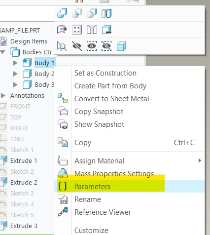

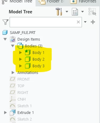

     I need to find the multi bodies parameters. I have a multiple body, like Body1, Body2, Body3, etc... Now I want to find these bodies parameters by iterating each and every Body in the 3D Model. So, I need any sample code in VB API to execute this.
