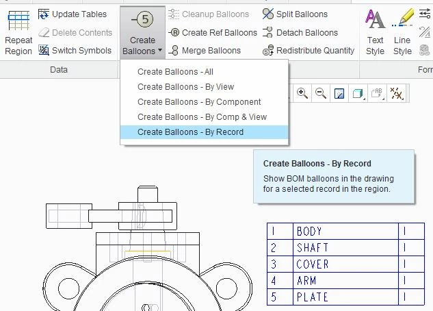

I had set up a table that contains the repeat region. I could have the balloons shown by ALL, BY VIEW, BY COMP, BY COMP & VIEW but not By Record.
Creo prompts "Select a bulk or included item record from the BOM table.", but as I click on any single item in the table, nothing shows up and nothing changes.
Also, as an equivalent of this feature, the toolkit API function: ProBomballoonByRecordCreate() keep returning an error saying "PRO_TK_BAD_INPUTS - One or more of the input arguments are invalid."
Does anyone here have a clue how use this feature?

It works!
Thanks for detailed explanation.
Aug 4, 2014 2:39 PM UTC
I am having the same issue. Can't select Ballon By Record.
Yes this video from Blue Duncan works when creating a bulk item. But still the problem with selecting an existing item/record remains.
Is this option only for Bulk items?
