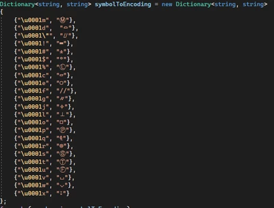

Hello all,
Need an idea to retrieve GD&T Feature Frame symbol from 3D Notes into MS-Word document.
(Using VB API or J-Link)
Jul 27, 2023 7:39 AM UTC
okk,
First u will takes the notes as string.
after use some regex that matches with GD&T symbols.
and also make some dictionary like this
this dictionary is used for replace the Unicode with Symbols.
get iterate with string and regex .
if the string match with regex, it will retreive that Symbols.
Jul 19, 2023 7:25 AM UTC
1. regular expressions
2. using ProDtlnotelineTextsCollect()
Each line of note can contain numerous ProDtlnotetext.
For example (past this text to Note properties)
"UNLESS OTHERWISE SPECIFIED, RADII {1:XXX#1} {3:mm}"
{1:XXX#1} - this is ProDtlnotetext one
{3:mm} - this is ProDtlnotetext two
