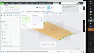

I'm not sure what you are explaining. Can you provide a screen shot?

This is a boundary blend... in the past the dialog box would remain closed forcing the user to open the box to add other direction for example.  I had to pan the model out of the way to make my selection.

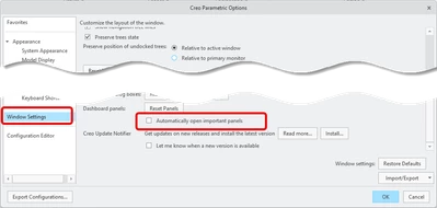

MikePhillips
Oct 14, 2024 4:01 PM UTC
I think this is the setting you want. Not sure if there is a config.pro option for it or not.
