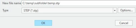

Rather than picking the folder location in the user interface, if you paste in the folder location into the save dialog box then that path will be written to your mapkey:
~ Command `ProCmdModelSaveAs` ;\
mapkey(continued) ~ Open `file_saveas` `type_option`;~ Close `file_saveas` `type_option`;\
mapkey(continued) ~ Select `file_saveas` `type_option` 1 `db_539`;\
mapkey(continued) ~ Input `file_saveas` `Inputname` ``;~ Update `file_saveas` `Inputname` ``;\
mapkey(continued) ~ Input `file_saveas` `Inputname` `C:\\temp\\subfolder\\temp.stp`;\
mapkey(continued) ~ Update `file_saveas` `Inputname` `C:\\temp\\subfolder\\temp.stp`;\
mapkey(continued) ~ Activate `file_saveas` `OK`;~ Activate `UI Message Dialog` `ok`;\
mapkey(continued) ~ Activate `intf_export` `OkPushBtn`;
