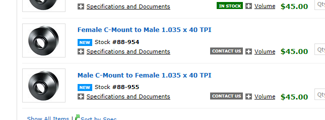

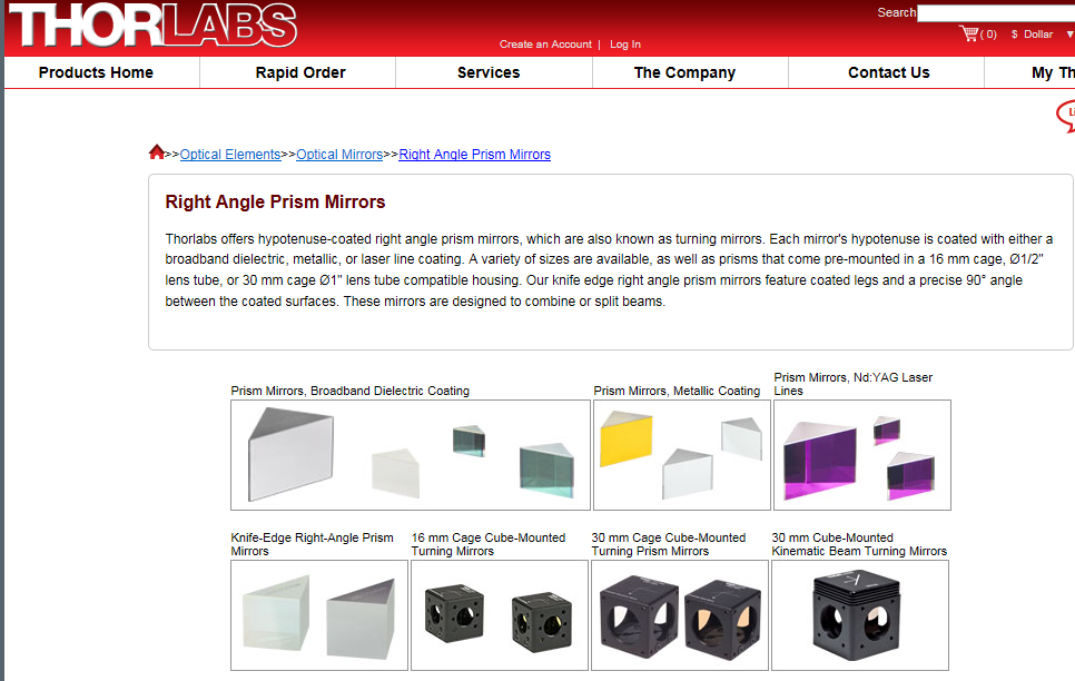

Don't use a prism, use a mirror.  Thor Labs has what you need.
C-mount adapters to ThorLabs 1" tubes (1.035 x 40 tpi) can be had from Edmund Optics

I think I was actually referring to a cube-mounted turning prism mirror.
