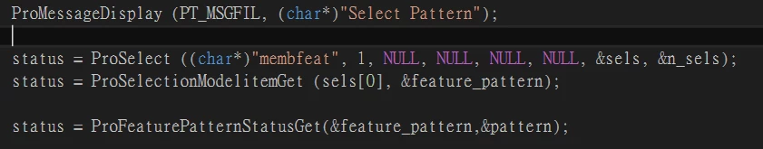

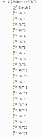

I have a problem about using pro/e toolkit to export points coordinate from Pattern。
Following is my program
I have got the selected pattern id & handle ,how can i get points xyz coordinate in the pattern?
Thanks and Regards
Roger
December 17, 2019
You got the feature handle now you have to get the element value of it using API ProFeatureElemValueGet
