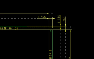

I want to highlight overlap dimensions in drawing view..
Is it possible through toolkit

What do you mean by overlap dimension?

For examble one dimension overlap with
another dimension or dimension arrow (Added image for example)

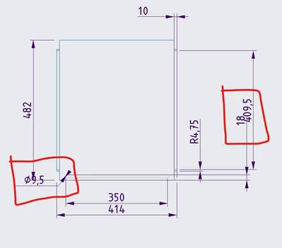

Are your engineers using Snap Lines in the drawing?   If they lock the dimensions to the snap lines they will  always maintain their spacing and avoid overlap.   In the image the snap lines are the dashed lines.  They do not show up in prints/exports.
