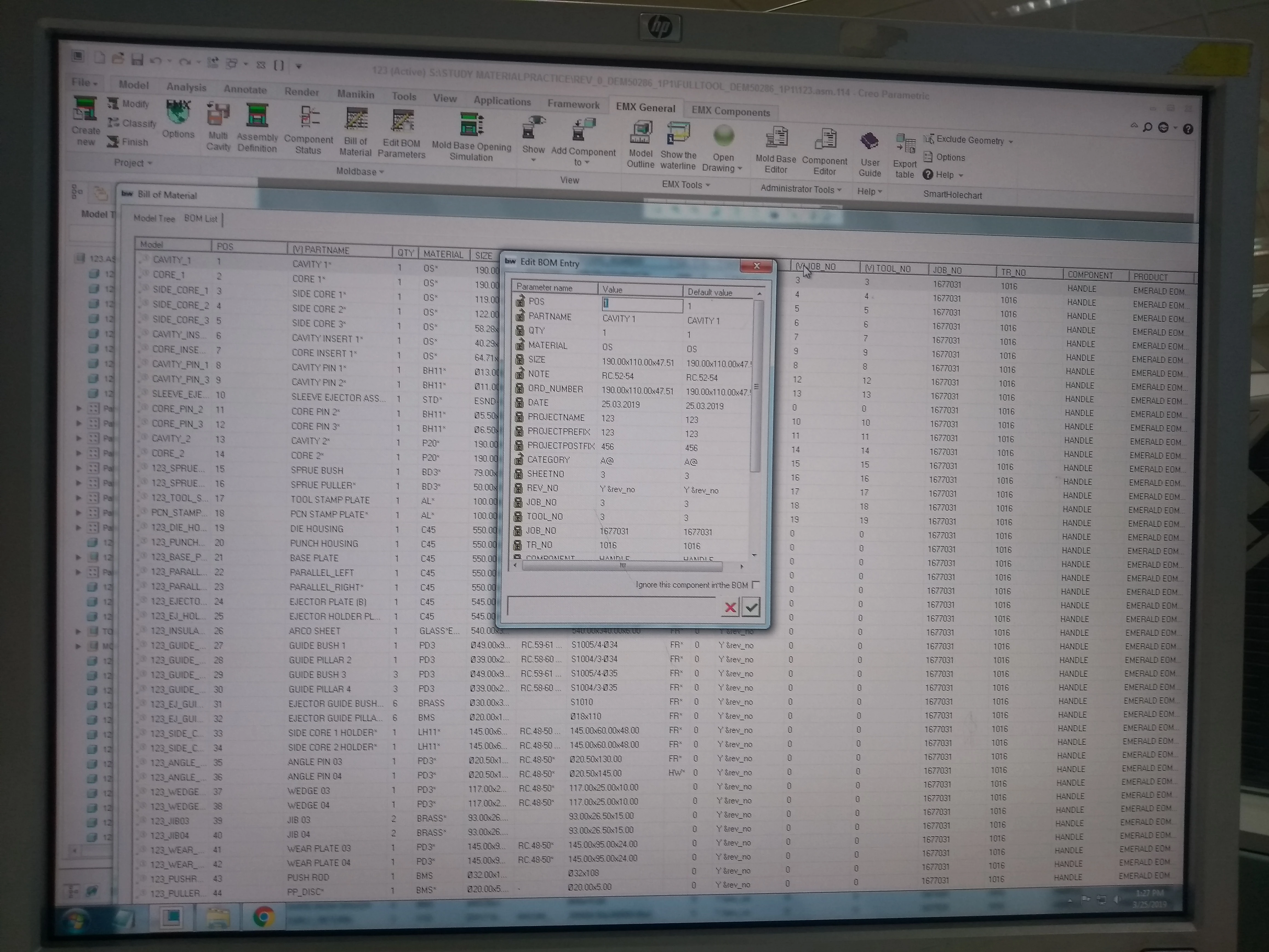

Mar 25, 2019 8:02 AM UTC
This is how i change the parameter value
Mar 25, 2019 8:20 AM UTC
so ... you do not use OOTB Creo functionality. Instead of it, you use functionality of EMX (Expert Moldbase Extension) developed by B&W software. Maybe @tschneyer  can answer your question. I guess BOM information is not associative with model.
