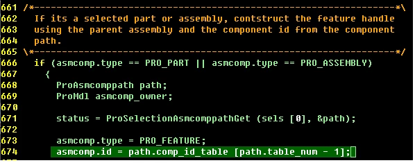

I use the following code to get the constraint of selected component in assembly
ProError status;
	ProSelection* sels;
 int n_sels = 1;
	ProFeature *feat;
	ProAsmcomppath path;
	ProAsmcomp *AsmComp;
	ProAsmcompconstraint *constr;
 status = ProSelect("part", n_sels, NULL, NULL, NULL, NULL, &sels, &n_sels);
 if(status != PRO_TK_NO_ERROR || n_sels == 0) return status;
	status = ProSelectionAsmcomppathGet(sels[0],&path);
	status = ProFeatureInit(path.owner,path.table_num,feat);
	status = ProAsmcompConstraintsGet((ProAsmcomp *)feat,&constr);
 return status;
but I get error PRO_TK_INVALID_TYPE (-18)
Kindly help me

Select a Feature or a component, check that you get the correct feature ID.
Manjunath1-VisitorAuthor
May 29, 2019 5:42 AM UTC
@RPN , I tried to retrieve the ID of selected component, its returning correct value. But I coudn't  get constraints

ProFeatureInit(path.owner, path.table_num, feat) makes absolutely no sense... the second argument is wrong because instead of an id you are using a count... you also had declared 'feat' as a pointer to the ProFeature - which is also wrong because ProFeatureInit would need sizeof(ProFeature) for its output argument instead of sizeof(ProFeature*)...
Take a look at UgAsmcompConstraint.c in protoolkit installation directory.
ProSelectionModelitemGet is all you need if you have a selection object.
'path.comp_id_table...' and so on is what you'll need to pass to ProFeatureInit if that the route you want to go.tttt.png
