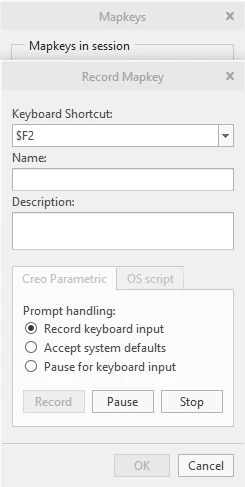

I want to know if we can pause for keyboard input in mapkeys like we did in the link below but for the popup window that appears when we do File/Save as in order to change the name of the file.
https://community.ptc.com/t5/Customization/Pause-for-keyboard-input-in-mapkeys/td-p/419676
My goal is to create a macro which transform an .asm file into an .iges file and pause in the middle of the macro to ask for the user's input to change the name of the file

Dec 15, 2023 12:12 PM UTC
When recording the mapkey, just hit the pause button in the dialog box. It will ask you to type in a "resume prompt" which is what the mapkey user will see while its paused.
Alternatively you can just manually edit the mapkey and insert this:
mapkey(continued) @MANUAL_PAUSEPrompt Goes Here;\

Dec 15, 2023 12:13 PM UTC
Pause button:
