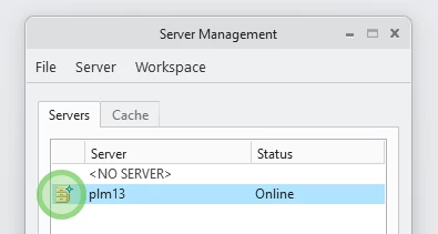

The Windchill server should already be registered and set as the Primary Server in the Creo session:

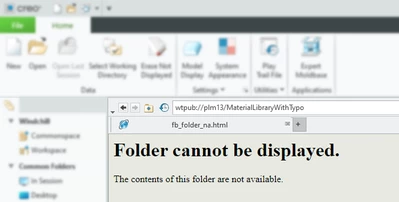

In case it still throws the ToolkitNotFound exception, make sure the full path of the material library you pass to the RetrieveMaterial() method is valid.
You can check this easily by copying the full path of the material location (in the screenshot here, that would be wtpub://plm13/MaterialLibrary for example) into the address bar of the embedded browser in Creo. When you hit Enter, it should take you to the material library in Windchill.
If the path is not valid (due to a typo or a wrong servername of foldername) then you will get this message:
