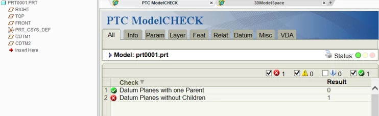

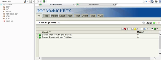

I am working on ModelCHECK and wanted to test 2 of the parameters("PLANE_CHILD" and PLANE_PARENT”) I was interested in-
I created DTM1 as a 0 inch offset of FRONT and DTM2 is a 0 inch offset of DTM1, I should get 1 PLANE_CHILD error for DTM2 and 2 PLANE_PARENT errors for DTM1 and DTM2, instead I get no errors-
As you can see above both the tests have passed. But according to definition they should have failed.
Please let me know if I am doing something wrong or interpreting definition wrongly.

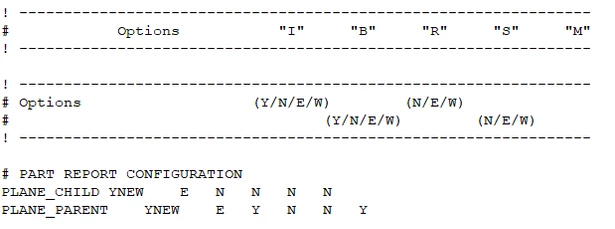

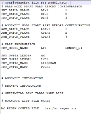

Following are my settings in start file:
Following are my settings in check file:
UPDATE: I was able to figure out the issue with PLANE_CHILD, since the start file had DTM1, DTM2 and DTM3. I simply had to rename the Datums to get the error.
But still I am not getting the PLANE_PARENT error
