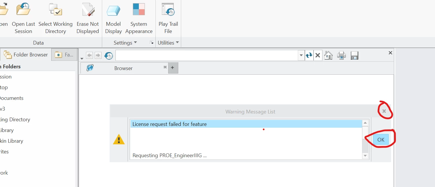

Hi Team,
I have attached a snapshot.
I am using C# for my uses and vb API to communicate creo app. my requirement is to be control on pop-up message's "OK" or "Close" button, Is there any way to get control on this "OK" or "Close" button from my C# code? I mean want control to close that pop-up from my C# code using vb API.
Any suggestion  would be appreciated.
Jan 24, 2024 7:56 AM UTC
RPN
18-Opal
Jan 15, 2024 10:37 AM UTC
Modify your psf and don't load invalid modules. In asyn mode, check the trail command if you press the required button, next execute this mapkey to destroy the window.

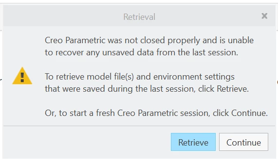

I am keep getting warning popup, error popup and recovery popup. so i want handle with my app, which i am connecting via VB API (Ipfc). want to get popup info and close it programmatically.
sharing snapshot.
RPN
18-Opal
Jan 18, 2024 8:10 AM UTC
You may check the Notification Center, this is configurable with config settings as well.
