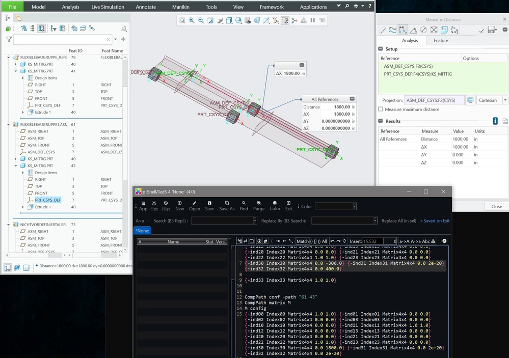

I've attached an example with two flexible assemblies. Each of these assemblies contains two parts whose x-position is controlled using a variable dimension. Now my task is to get the "actual" position as it can be seen in the main assembly. I obviously can't use wfcWComponentFeat::getPosition as this gets me the "as constructed" position. I tried to call wfcWComponentFeat::Refresh and wfcWComponentFeat::RefreshRelations before calling getPosition but this hasn't changed anything... Do i have to calculate the correct position myself or is there some kind of "trick" that i have to do in order to get the correct position?

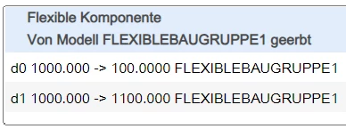

Maybe (probably) my description was a bit too vague. So here is a screenshot from the KE-information of one of the flexible parts in the with the information i need to retrieve:
For all non-native german speakers this roughly translates to: Flexible component Inherited by model FLEXIBLEBAUGRUPPE1.
I am able to get d0 and d1 but i get the default values (1000.0) instead of the inherited ones...
Any input would be appreciated as i ran out of ideas what else i could try...

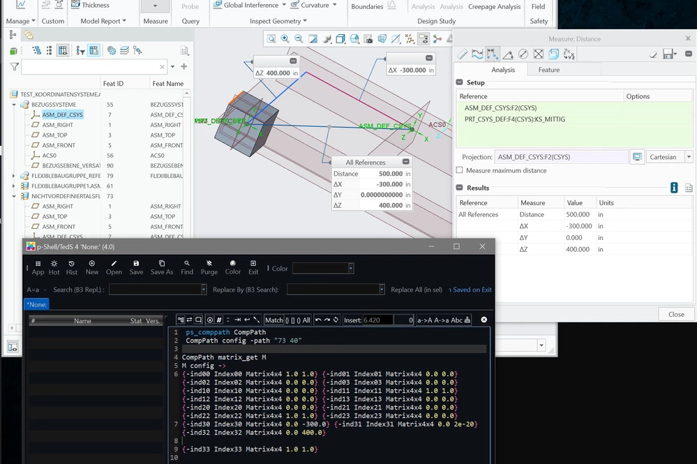

Okay my assumption you assembled on def csys, next I measured and tried to get the matrix. For me it looks okay
Some more details from your side would be nice 🙂
Take care how to create a csys and how to measure. Start with PTC defaults first. Get Up or Down is a flag as well.
# Notes if needed
# Create a Component Path Object
ps_comppath CompPath
# configure the path
CompPath config -path  "61 43"
# get the Matrix
CompPath matrix_get M
# Show all Matrix Data Index30-32 are the transformation
M config
