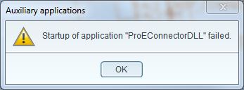

I am developping a bit with Pro/Toolkit. First I did my application as spawn mode (exe) as they advice us. I have no problem with that, I compile it and register it and then it works fine in ProE 64 bits. Then I decided to do the same application but as DLL mode in order to have my application running faster but I can't get it to work :
non pb with compilation , then I register it like this :
name ProEConnectorDLL
startup dll
exec_file C:\Devel\ProEConnectorDLL\x64\Debug\ProEConnectorDLL.dll
text_dir C:\Devel\ProEConnectorDLL\text
delay_start TRUE
allow_stop TRUE
REVISION 18
end
then I launch it thanks to Tools/Auxiliary Application but when I start it I get the error message : startup_failed.JPG
Please help!

Did you check the trail file after the application run?.
Can you send what your userinitalize looks like.

Sorry if my question seems simple but where can I find the tail file?
Here is my userinitializee :
extern "C" int user_initialize()
ProError err = PRO_TK_NO_ERROR;
ProMode mode = PRO_MODE_UNUSED;
err = ProModeCurrentGet(&mode);
if(err == PRO_TK_NO_ERROR)
if(mode == PRO_TK_BAD_CONTEXT)
printf("ProModeCurrentGet error in user_initialize.\n");
return(0);
Thank you

I don't think trail file will help a lot... Generaly there is only a line with the same message than the error dialog...
First of all, you must check if the protk.dat paths are good in Help->System Informations->Auxiliary application Information.
If everything is OK, check if all dependancies of your dll is in the same directory.
BR,
Etienne

I checked the path from the protk.dat and they are good. I renamed the dat file protk_dll.dat, I guess it's not a problem.
I checked the dependencies and they are all in the same directory...
Do you have a small example project ofr example? I am using Visual Studio 2008 Express. Maybe it's something in the configuration of my project, if I could compare with a working .sln it could be very helpful
Thank you a lot!
May 23, 2013 8:38 AM UTC
Try with filename protk.dat instead of protk_dll.dat
