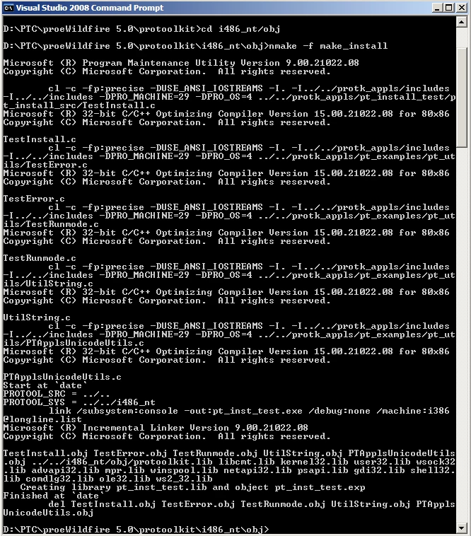

According to the release notes for Wildfire 5.0, "All Pro/TOOLKIT applications on 32-bit and 64-bit Windows platforms must be built using the Microsoft Visual Studio .Net 2008 compiler"
I'm trying to follow the Pro/TOOLKIT Getting Started Guide that came packaged with WF 5.0, using Visual Studio 2008, but I am running into issues compiling the make_install walkthrough app. I suspect VS2008 and the makefile included in the project are not getting along.
Has anyone gotten this to compile under VS 2008?
June 26, 2010
Can you share the errors you are getting?
I am able to build the test examples from the WF5 package. Please see
attached snapshot.
Vinay
