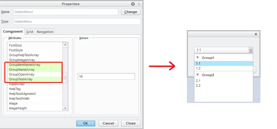

Pro/TOOLKIT. How to in ProUIOptionmenu create a groups programmaticaly?
Hello.
In ProUIOptionmenu (Drop down ListBox) it is possible create a groups using .res file:
(Resources
 (OptionMenu1.GroupNames "1"
 "2")
 (OptionMenu1.GroupLabels "group1"
 "group2")
 (OptionMenu1.GroupItems "1"
 "3")
How to create this groups from C code for TOOLKIT? Any idea?
Jul 4, 2018 6:44 AM UTC
It seems same is not feasible with code.
I agree with you @Ketan_Lalcheta. Looks like old C TOOLKIT can't do this.
But PTC point me that OTK have methods for classes uifcOptionMenuGroup in uifcOptionMenu.
If you have an ideas - you are welcome. My res file in attachment.

Hi I am not getting your expected result specially groups inside option menu. Values one can set for option menu as per attached file. There is a way to do so through API as well as res file. Could you please show what is your expected result in option menu?
Jul 4, 2018 4:36 AM UTC
Hi @Ketan_Lalcheta
In Creo UI Editor (*.res) I can create a groups like in picture
Looking a way to do this at runtime in C code.

It seems same is not feasible with code. Still I wanna do reverse engineering. Could you please share dummy res file for option menu with groups?
