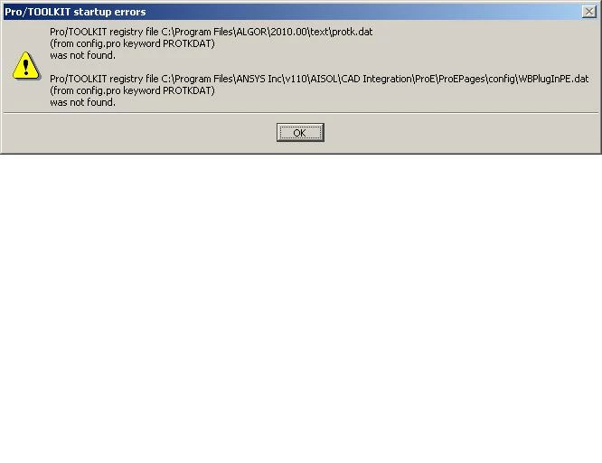

Does anyone know how to get rid of Pro/TOOLKIT startup errors in WF4?
I have looked for the standard location of protk.dat and am not finding any entries within it.

This one seems to be defined in your config.pro. Go to Tools > Options and
look for the protkdat option in the current session.

First look to see where Pro-E is getting its protk.dat file from.
in Pro-E under Help | System Information
look at the results under 'Configuration Files Read'
several of the places pro-e may find the files are as follows:
<loadpoint>text\
Start in directory
Root of Start in Directory
