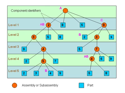

A component path is just a list/array of component identifiers from the Root Assembly to the selected component. You need to tell toolkit which level/depth and the identifier. This will enable you to uniquely identify a component in an assembly (max level is 32) even if you have the same component more than once in one level.
The path and/plus the model item together is is always unique. The model item alone may not.
The model item owner must be the same model as specified with your path down.
If you assemble a part, then for this component the path is not needed, this is true as well on assembling an Assembly and you specify model items, like an axis from this assembly.
In most other cases you need to deal with the path.
If you allocate a selection make sure the path match if you specify a model item as well.

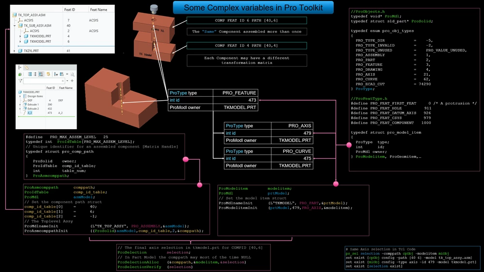

Jan 23, 2025 10:45 AM UTC
Maybe this helps,
it may have built in errors, but it's for free 🤣
This shows how to setup "One" axis selection of a component in one sub level, plus some header includes  (only for ref, for sure not complete 😀).
See Toplevel Assy Picture (Top Left) and the tkmodel.prt (below) for some details related to the code.
Selection is always fun, but straight forward if you spend time on it ! (I still like the old Pro Develop style more)
Note: If you call for a Solid ProMdlToModelitem, the model item ID is equal to ProMdlIdGet(). There are tone of calls to access the model database and the memory tables, and modelitems are frequently use with different aliases to make it more complex 🙂
And of course no error checking. I compiled this and the selection was valid 🙂
ProAsmcomppath comppath;
ProIdTable comp_id_table;
ProMdl asmModel;
// Set the component path struct
comp_id_table[0] = 40;
comp_id_table[1] = 6;
comp_id_table[2] =-1;
// The Toplevel Assy
ProMdlnameInit (L“TK_TOP_ASSY“, PRO_ASSEMBLY,&asmModel);
ProAsmcomppathInit ((ProSolid)asmModel,comp_id_table,2,&comppath)
ProModelitem modelitem;
ProMdl prtModel;
// Set the model item struct
ProMdlnameInit (L“TKMODEL“, PRO_PART,&prtModel);
ProModelitemInit (prtModel,479,PRO_AXIS,&modelitem);
// The final axis selection in tkmodel.prt for COMPID [40,6]
ProSelection selection;
// In Part Model the comppath may most of the time NULL
ProSelectionAlloc (&comppath,&modelitem,&selection)
ProSelectionVerify (selection)
The PDF may have a better quality,
If you find errors, i will not spend time to update this 🙂And I was wrong with 32, there are only 25 levels allowed.
Feature based assembling, as far I remember, was introduced with approx. Pro/ENGINEER 8, it was not there from the beginning.
Cheers -)
