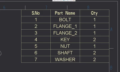

Hi all,
Unable to create balloons from repeat region bom table. I'm getting return error (Drawing not displayed) for last line api "ProBomballoonAllCreate". but drawing is already displayed. Also Only one dwg table present inside drawing.
https://www.ptc.com/en/support/article/CS276430 . Already tried with this solution, but still no luck
status = ProDrawingFromTmpltCreate(model_name, drawing, &model, PRODWGCREATE_DISPLAY_DRAWING, &newdrawing, &errors);
int drw_windowID;
status = ProMdlWindowGet(newdrawing, &drw_windowID);
ProWindowActivate(drw_windowID);
ProWindowRepaint(drw_windowID);
ProDwgtable *tables = NULL;
status = ProDrawingTablesCollect(newdrawing, &tables);
int regionId ;
status = ProDwgtableCellRegionGet(newdrawing, &tables[0], 0, 1, &regionId);
status = ProBomballoonAllCreate(newdrawing, &tables[0], regionId);
Thanks.

Yes, I fixed it. In API "ProDrawingFromTmpltCreate" argument "PRODWGCREATE_DISPLAY_DRAWING" changed to "PRODWGCREATE_WRITE_ERRORS_TO_FILE" has solved this

I'm not familiar with Toolkit, but should this code reference the drawing view, and not the new drawing for the BOM balloons?

I guess you have it already fixed, but the drawing must be displayed in a Window.
