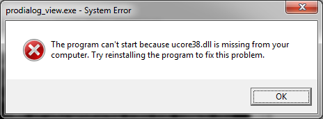

Has anyone received the following error when running prodialog_view.exe? WF 5.0 M070 x32 and x64.

Hi Patrick,
I have seen similar errors in the past with other apps. It almost always
boils down to a pathing issue.

Hi Patrick -
Following up on Ben's comment, I found ucore38.dll here:
<proe_root>\i486_nt\lib\ucore38.dll
<proe_root>\i486_nt\obj\ucore38.dll
These two DLLs are identical; take your pick. They appear
in WF5 but not WF4.

Yea thanks guys. I found them after I sent the note to the exploder. So that dir should be in the path OOTB? Why isn't it?
