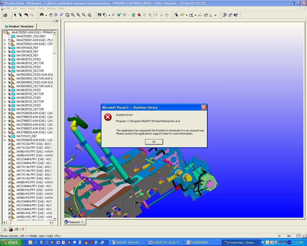

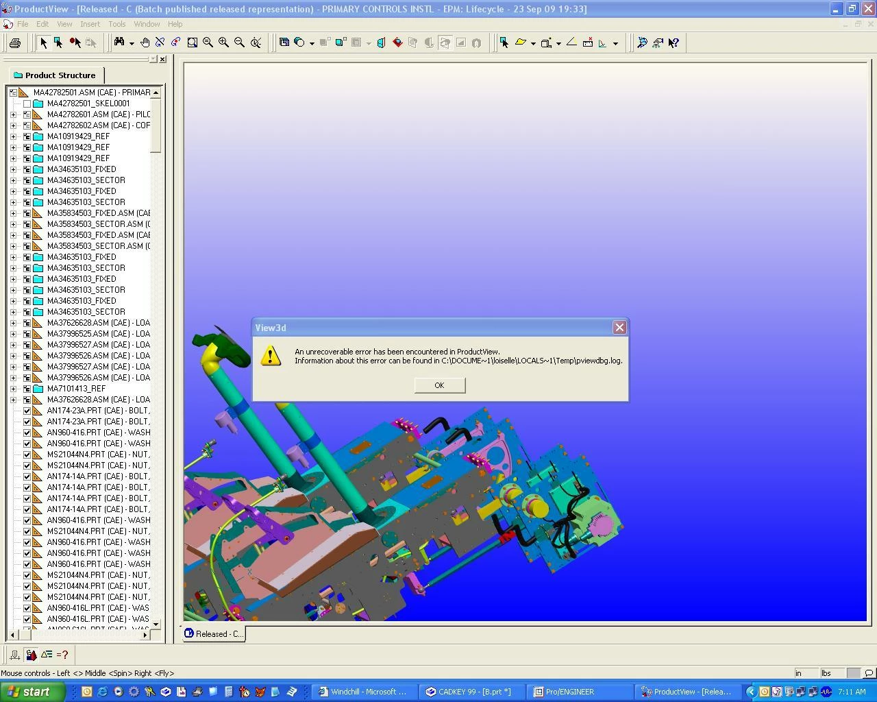

ProductView Client exits while spinning/panning a model and holding the shift key, thiswill generate the following errors and leave the process pview.exe open in the task manager.
  1. An unrecoverable error has been encountered in ProductView.
    Information about this error can be found in c:\DOCUME~1\username\LOCALS~1\Temp\pviewdbg.log. [OK]
  2. Runtime Error!
    Program: C:\program Files\PTC\ProductView\pview.exe
    this application has requested the Runtime to terminate it in an unusual way.
    Please contact the application's support team for more information.
The contents of pviewdbg.log is this:
========== ProductView Exception occured on February 22, 2010 at 15:23:27 =======
Version: ProductView (TM) - 3D/2D Viewer ActiveX Control Datecode: M050
OS Version: Windows NT 5.1 Build 2600 Service Pack 2
Display Driver: NV4_DISP: Resolution: 1280x1024 @ 32bpp
pview.exe caused a EXCEPTION_ACCESS_VIOLATION in module View3d.ocx at 001B:01AE64FA, PVComponent::operator bool()+1882 byte(s)
EAX=00000000 EBX=01DBF700 ECX=00000000 EDX=00000003 ESI=00E60260
EDI=00E31C90 EBP=0012E910 ESP=0012E90C EIP=01AE64FA FLG=00010206
CS=001B DS=0023 SS=0023 ES=0023 FS=003B GS=0000

Turn off Advanced Rendering in Graphics Properties
I'm trying to remember, I think If you right click in the model window and
select properties its in the graphics section
