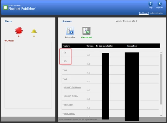

Feb 15, 2018 9:32 AM UTC
James,
Thanks. It helped me partially. The license entry on my psf file shows. protoolkit_License_Entry.PNGI do not see an entry "PROE_ESP1"..
My license server is also configured right. I cross verified. I still get the same error.
