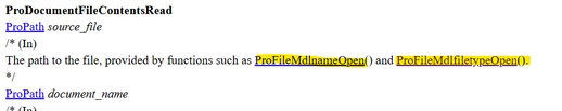

Hey, thanks for your help, yeah, I already inspected the ProUtil.h library, and it seems those functions work with a path which is returned by some other functions that require manual intervention (like to select a file from a popup window), that function would be helpful if accepted the direct Windchill URL.
This function seems to be useful to copy the file from the workspace to a local directory, but we also need first to add that file from Windchill to a worskpace:
This other function would help me to get either the primary or secondary content, but I also need first to know the file URL:
