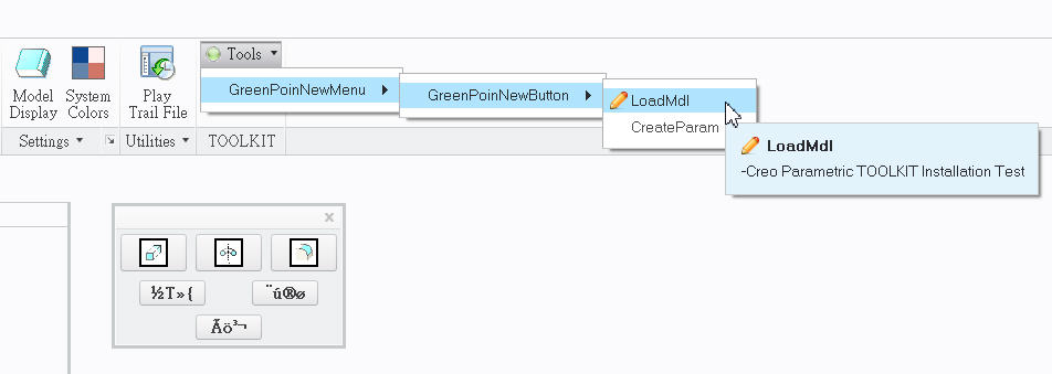

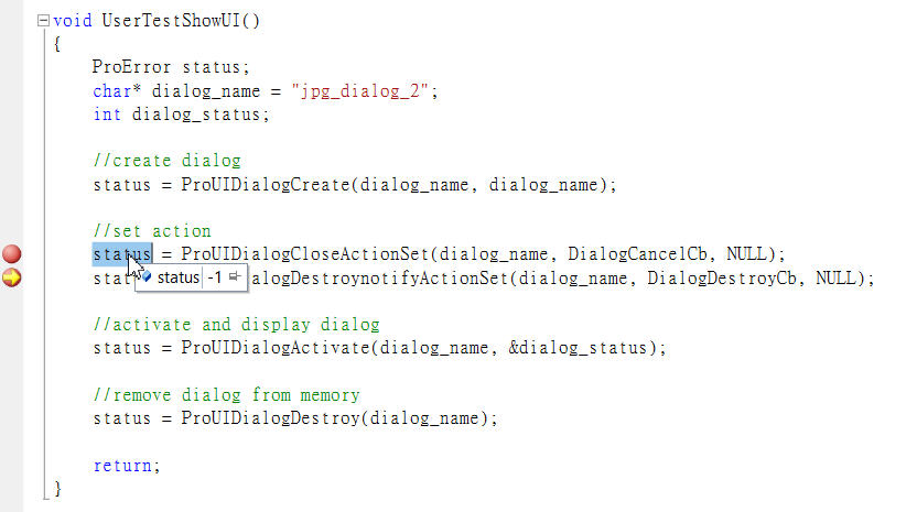

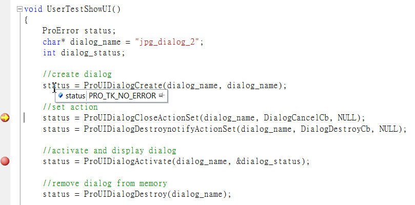

I got a problem about created dialog, the steps create -> activate -> exit -> destroy worked fine at first but second time failed.
creo 2.0 M230
win7 x64
first, dialog shows normally
after close dialog then click button again, dialog doesn't show up
this discussion describes the same situation but the solution doesn't work for me.

If the status is -1 he can't create the dialog because the old one is created already.
Or he can't find the .res file because it's at the wrong location. (Could be also a problem with the resource remembering management).
