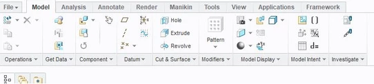

Hello all,
I have an issue with creo 3.0 which occurs from time to time. Obviously I am inadvertently hitting a hotkey which make all of the quick access toolbar reduce to an icon only interface, see below:
To date, the only solution I have for this is to close the part/assembly and reopen it in order to restore the default appearance (below). Anyone know of an easier fix?
July 15, 2020
I've run into this issue many times as well. I've never nailed down the cause though...
What I do to fix it is resize the window and then make it full size again. If you use the Windows shortcuts to do this, it's pretty fast. Here's an example:
Click on the Creo Window
Windows Key + Left Arrow - To snap window to the left side of the screen
2x(Windows Key + Up Arrow) - To maximize the Window size
