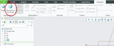

Can't you accomplish more or less the same by using the new functionality "Reconstruct from facets" in FreeStyle?
Best regards,
      John Bijnens
