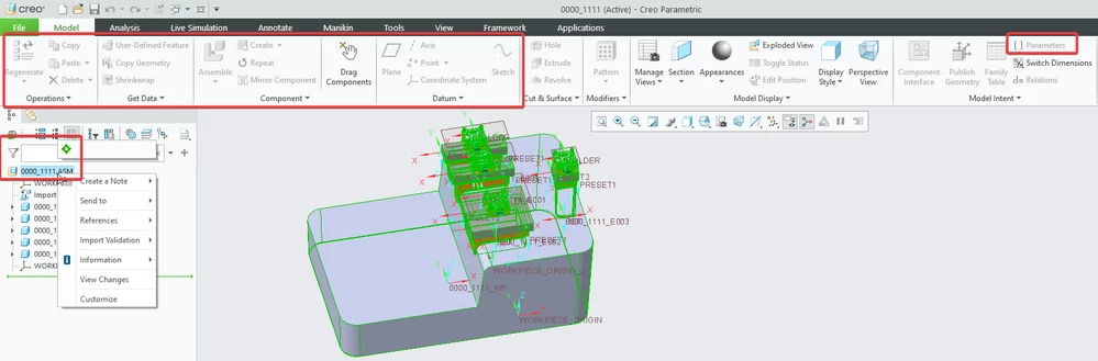

Good morning everyone,
I'm using Creo 10 and from the "Tools" ribbon menu I start my c# application.
We can do everything but in the "Model" menu a lot of function are disabled especially "Parameters". I don't understand why this happen when we start our application and from that application we are able to delete all the custom "Parameters".
When we close our app I thought the menu will be active again but this doesn't happen and if I do a right click in the assembly I have the icon for "Activate" it.

But nothing is working. I have to close the file and open it again to check the "Parameters".
How can enable, with ProToolkit API, the menu during Close function of my application?

It is hard to tell, my guess would be, that you closed a window, which was activated by your code. In that case you must activate the current window by using CTRL-A. You can save the current window ID, and restore it on app exit,

3-Newcomer
Jun 27, 2023 9:58 AM UTC
I already tried with restore window ID () and was not working.
Today I try again only with this API function:
ProError status;
int window_id;
status = ProMdlWindowGet(curModel, &window_id);
status = ProWindowActivate(window_id);
This it's working good. Re-enable the ribbon menu and I can check the "Parameters".
