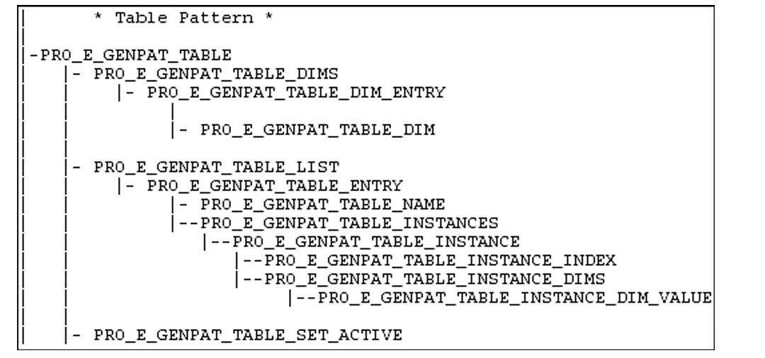

Is it possible to redefine/ modify pattern table using Creo toolkit C++? I am trying to update the dimensions using Ptb file which is used for read function of pattern table.
I am having issue to build element tree of this pattern table and to define first instance of this.
Is there any sample code for it?

Hello all,
By referring to this document I am able to redefine the pattern table.
https://www.ptc.com/en/support/article/CS261112
I have a doubt that if I have a group pattern instead of feature pattern. What changes should be made to the code?

Hello all,
I referred following document
I am able to define pattern table if it is a feature pattern but have doubt regarding group pattern. What changes are to be made if one is redefining a group pattern?
