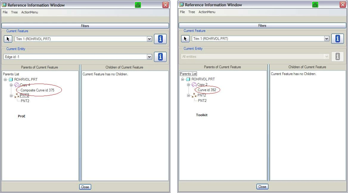

Hi Folks,
I am trying to create a Trim on a Composite Curve (via Copy Geometry).
This is possible if I am using ProE but if I try to solve the problem in Toolkit there seems to be a problem concerning the reference to the curve.
I have tried both ways:
- Feature Tree Creation
- UDF Creation
but in both cases the reference to the curve seems to be illegal.
The Reference that is created by ProE during the Manual Creation of the Trim says Composite Curve, in comparison to this my Toolkit created reference only says Curve.
The difference is the fact that my reference in Toolkit is not marked as Composite Curve. (see Screenshots --> attached)
Has anyone experience concerning Composite Curves and Referencing?
I would be thankful for any suggestions.
