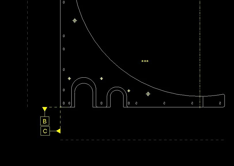

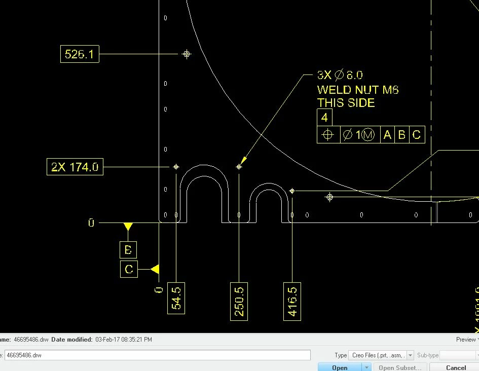

Dear All,
Can anybody help me resolve the issue.
I can see updated drawing in preview but when it is opened there are no dimensions.
Below error comes when drawing is opened.
Related objects are freed if their host is deleted .
I have attached snapshots for reference
Thanks in Advance.

The error message is just a symptom. The preview is how the drawing was last saved, BUT in my experience, this is what happens when the .prt (or .asm) is either not saved or is for some reason not the version that was saved with the drawing.

The message is because you had something like a symbol placed offset to a dimension, and the dimension has since been deleted in the solid.  This could be because a user retrieved the solid and deleted a lot of stuff, but is more likely that there was some user error in managing the versions of the solid, for example:
1) User A builds drawing D from P.PRT.4
2) User B deletes P.PRT.4 and .3, and redoes the development of the part from P.PRT.2
3) User A retrieves D, and D is trying to show things that don't make sense, like dimensions that 'have never been created'
The right answer is either do not roll back models that other models are using, move forward instead by deleting the new features you no longer want, *or* also roll back the models that reference and depend on this one.
