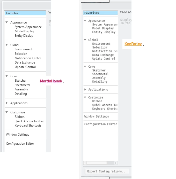

following picture shows that your Creo uses non-default font in UI. Maybe your config.pro contains DEFAULT_UI_FONT option.

I think minimum window size is hardcoded.

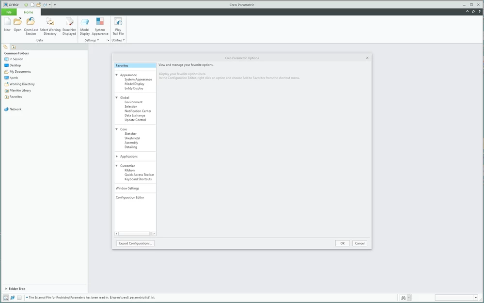

My Creo 9.0.2.0 pictures follow ...

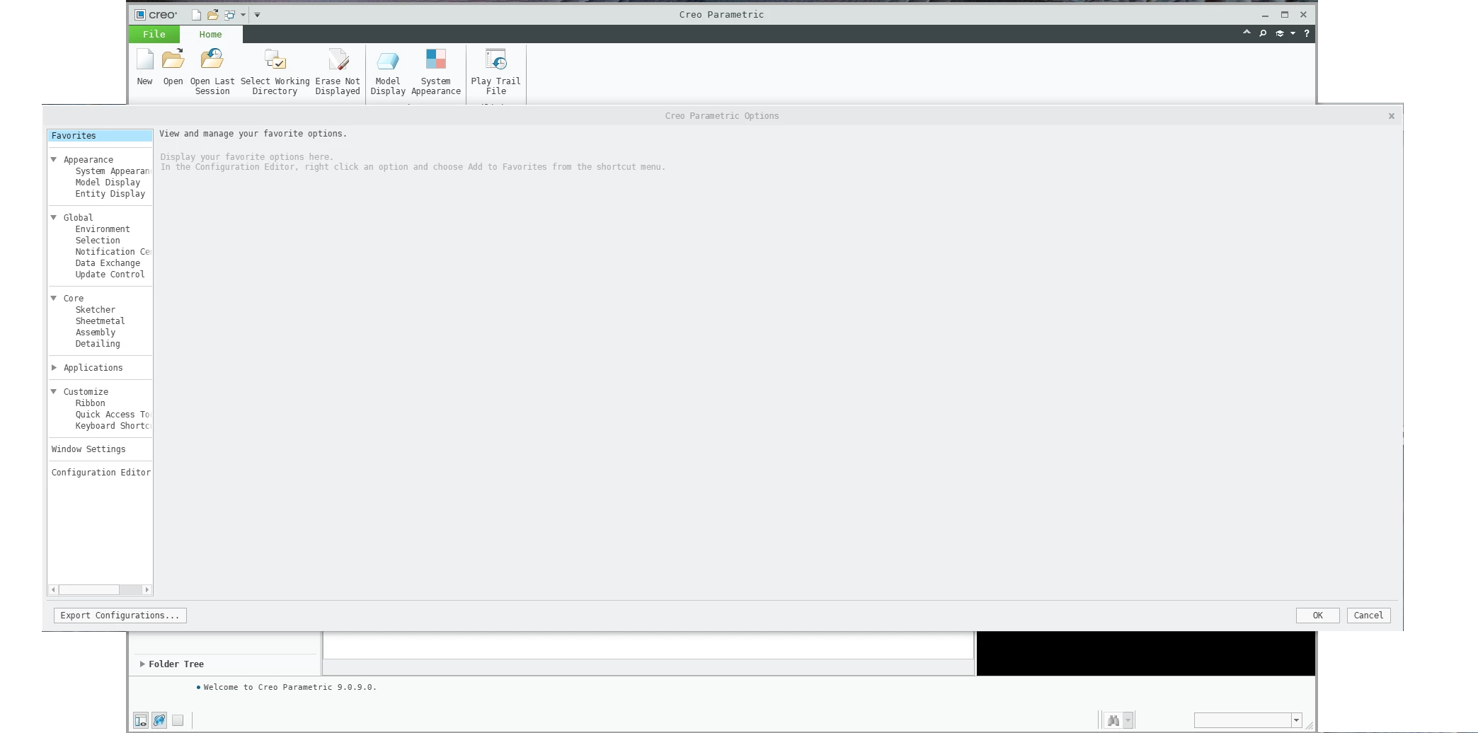

Attached is an image of my situation. The options window is ridiculously wide and I cannot make it smaller. If I expand it to make it even wider it will do so, but then it will be locked at that new, even more ridiculous width. Nothing I've tried has allowed me to diminish it. It's so wide that it spans from one of my monitors to the other. When it first pops up, the window usually has the "Okay" and "Cancel" buttons off-screen. The image attached is from a screen shot that takes both monitors. as one.
Note: This is the only dialog window in Creo that behaves like this for me. Fortunately, I am not changing my option settings on a regular basis, but still it is annoying.

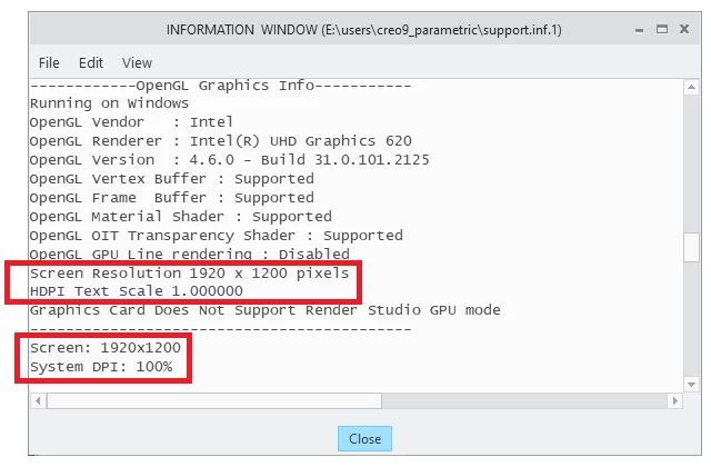

You have configured your own font, try start without any configuration and ui file.
And take care if you have configured a different scale for your fonts in Windows.

Following these steps, or deleting the creo_parametric_customization.ui file yields the same result: The size is no longer exceeding a single monitor. However, it is still the full width of the screen, and I still cannot make it any smaller. This leads me to believe that maybe the multiple monitors, for the options window, is causing a miscalculation of the default window size and the minimum allowable window size.
I'll try switching to single monitor and see if that does anything. I wonder, as has been discussed in the past, why the .ui file, which would be very helpful to fix such things, is saved in an unreadable binary format. Really not very helpful, is it?
If I find my theory about this to be correct, I guess I'll have to save that .ui file, use it when I go back to multimonitors, and submit a bug report about this.
