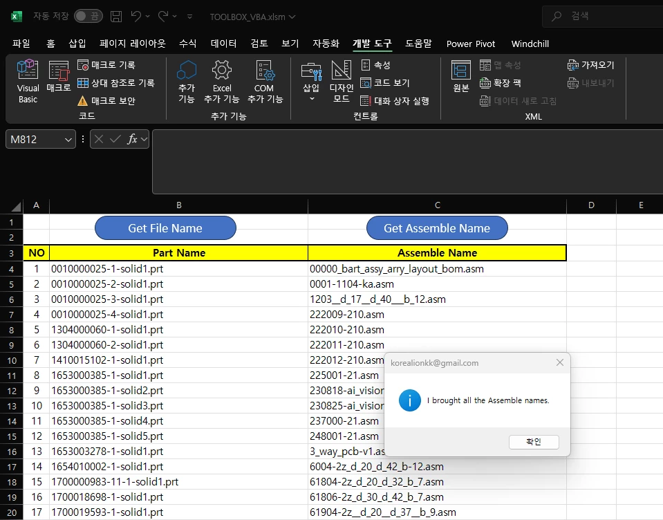

Sep 15, 2024 4:30 AM UTC
Hello
Here is the code to get the Creo file name in the working folder. Please note
I created the code using AI.
Dim stringseq As Istringseq
Set stringseq = BaseSession.ListFiles("*.prt", 1, "")
Sep 18, 2024 12:56 PM UTC
Hello
It may not be the feature you want, but I'm leaving a message because I think it will be a hint
I'll send you a function that checks if the model referenced by the assembly's component is not in the session
(see blog: https://tool-2020.tistory.com/1159)
