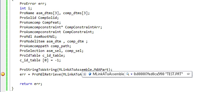

Hi all,
I try to retrieve model to assemble. I try to configure the model name in txt file.
ProStringToWstring(MLinkAToAssemble,MdAPart);
err = ProMdlRetrieve(MLinkAToAssemble,(ProMdlType)PRO_MDL_PART,(ProMdl*)&CompSolid);
I use the above code to retrieve model, but I get error PRO_TK_E_NOT_FOUND
whereas if i uses the model name directly I get the model in session
ProStringToWstring(MLinkAToAssemble,"TEST.PRT");
Kindly throw some light

check with value of variable once (MDApart in your case). It should not have space or something extra characters. Also check once that wide char name holds proper value after conversion from text file variable value.
Manjunath1-VisitorAuthor
Mar 14, 2019 9:59 AM UTC
@Ketan_Lalcheta  I have cross verified, herewith I have attached the image for reference
