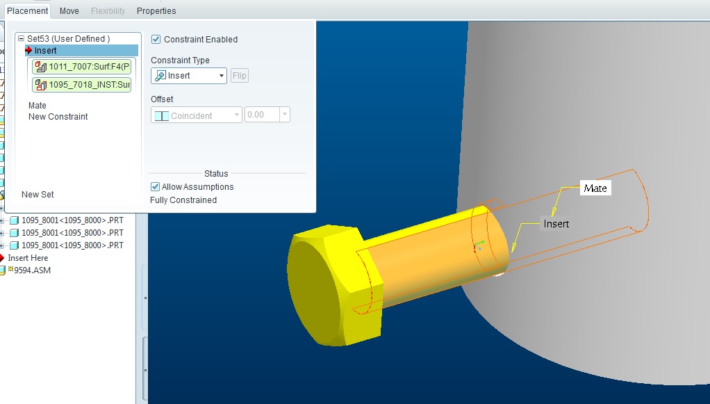

Only minor question left is when building assembly, how do I add parts in the area that I'm working versus back at the "origin"?
Dale_Rosema
Oct 22, 2013 1:18 PM UTC
Adding constraints to the parts in the assembly will determine where the parts are placed. If you are just putting them in as fixed in the assembly then they will not show in the appropriate places.
e.g. For a shaft, you would align either the surface of the shaft with the surface of the bearing, or align their axis. For things that are bolted. you mate the surfaces that touch, align one of the bolt holes and set the orientation with a second bolt hole.
Basically, it depends on the parts being added to the assembly and how you want them to be either constrained or partially constrained.
Thanks, Dale
The following picture shows the bold/nut ass'y "inserted" into the hole on the tube. The next constaint mates the nut with a feature on the inside of the tube. Allowing assumptions is checked because I do not need to lock down the rotational alignment of the bolt/nut assembly with respect to the tube.
