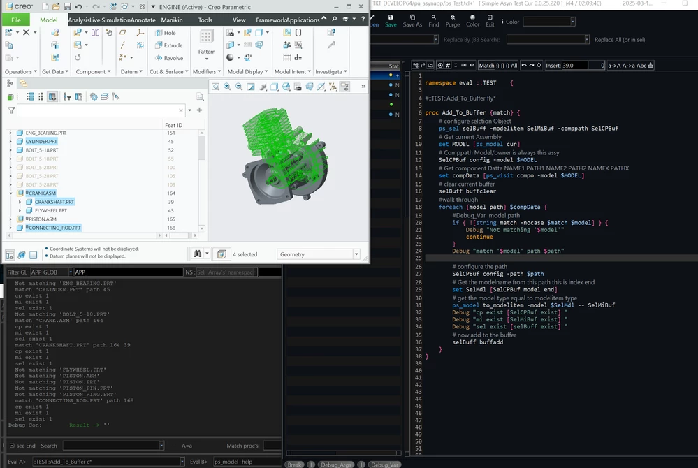

# final call with model name pattern c*
# c* will add parts and assemblies, for sure this works as well without wildcards 😁
# see image for some Debug output
::TEST::Add_To_Buffer c*

Did some changes, ToModelItem may better.
