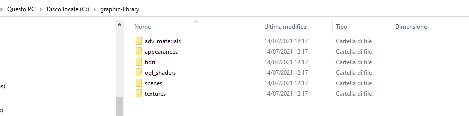

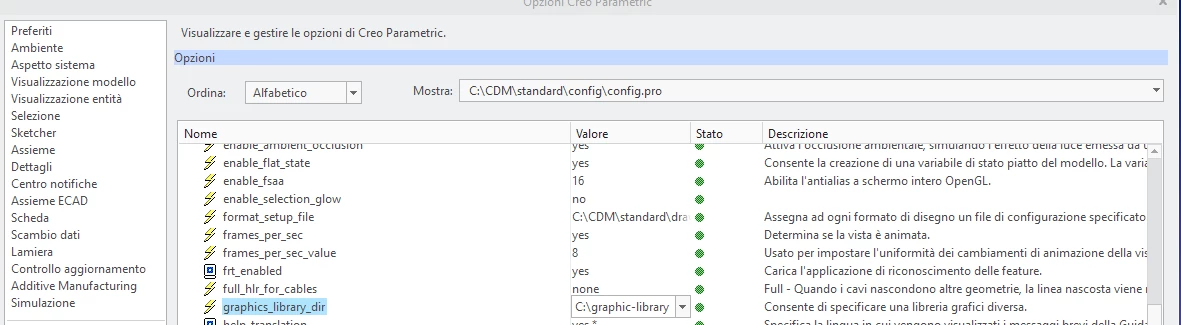

I set up the graphics_library_dir config.pro line to customize the Appearance Library in Creo Parametric 7.

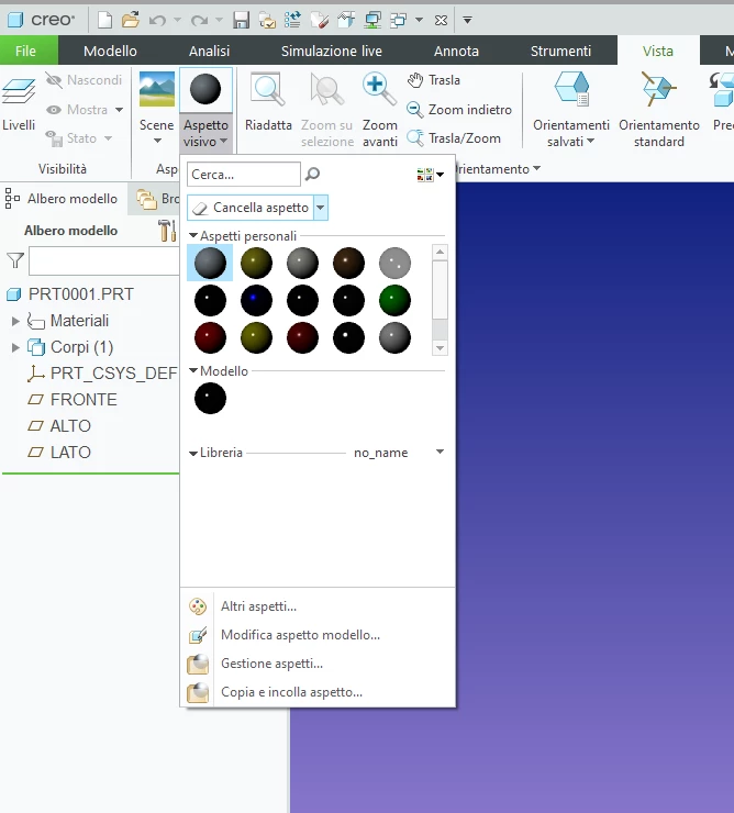

When I go into the aspects, the personal ones are all dark and the bookcase does not show any aspects.
The customized folder and sub-folder structure is exactly the same as the standard files that are in Coommon Filles etc.
Is there a way to set a different one? (see images 1, 2 ,3)

So judging from what you have in the two screenshots 1.png and 2.png perhaps your specification in the config.pro should be:
graphics_library_dir c:
since the option parameter is telling Creo where the top level directory "graphics-library" is located.
