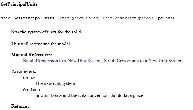

Hi!
Does anyone have any examples of how to use it?
I'd like to do this.
Thanks!

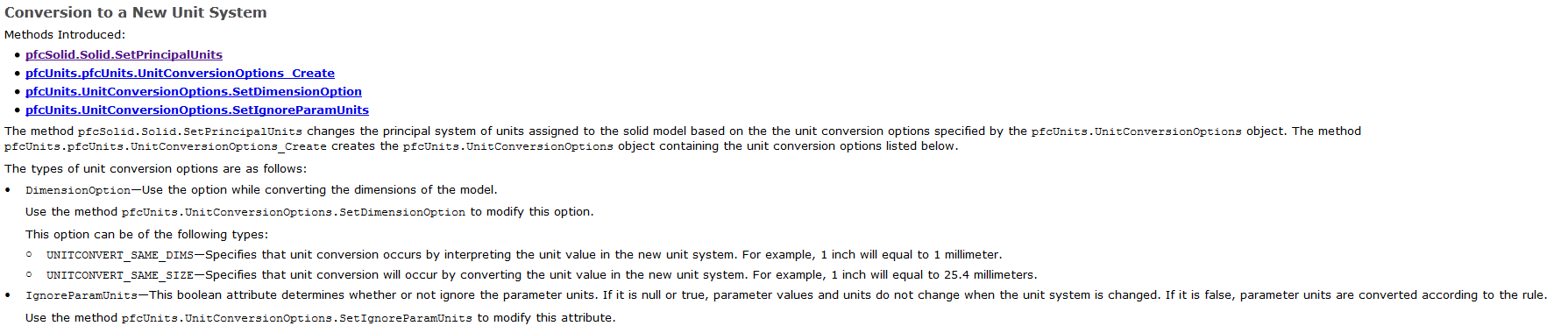

What I'm really trying to do is this:
I am at this point:
I did not understand how the "UnitSystem" work, which would be "null" in the code.
Thanks.
