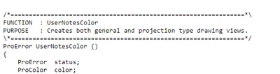

Mar 9, 2023 12:13 AM UTC
Function:
example:
msteffke15-MoonstoneAuthor
Mar 9, 2023 1:22 PM UTC
My issue was more concerned dealing with the Color structure, the fact that it contains Union,  and how to manipulate as I could find few examples.

 color.method = PRO_COLOR_METHOD_TYPE;
 color.value.type = (ProColortype)color_index;

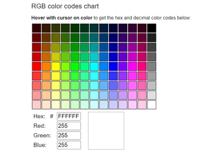

 I did finally find an example of setting up and RGB example and it was pretty simple.  With MyColor as a ProColor, I wanted to change a note to Cyan so I used the following lines to set up my Color varaiable.:
MyColor.method = PRO_COLOR_METHOD_RGB;
MyColor.value.map.red = 0;
MyColor.value.map.green = 1.0;
MyColor.value.map.blue = 1.0;
using this RGB color chart to help me figure out values,  In Creo rgb values go from 0 to 1 as opposed to 0 to 255
FV_01
Mar 9, 2023 5:03 PM UTC
divide an integer value from color dialog box by maximum possible value ( double 255.0). cast result to double.
