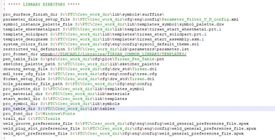

You can move the common file folder to a different location. However, the addresses in Config pro need to be edited.
For Example;
Oct 7, 2020 11:49 AM UTC
I have a single install of Creo on a server disk so everyone is reading the load_point Common Files folder by default. Makes upgrades easier as I don't have to go around to 20 computers to do an upgrade.
For the directories section of config.pro, we set a shared drive location X:/PTC_Settings and have templates, formats, notes, tables, etc, folders under that. We also have a PTC_Settings folder in WIndchill in a configuration setting library which has the formats, templates and start parts in it.
