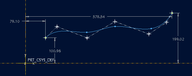

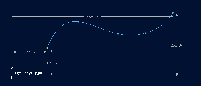

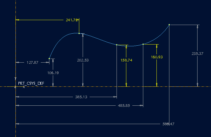

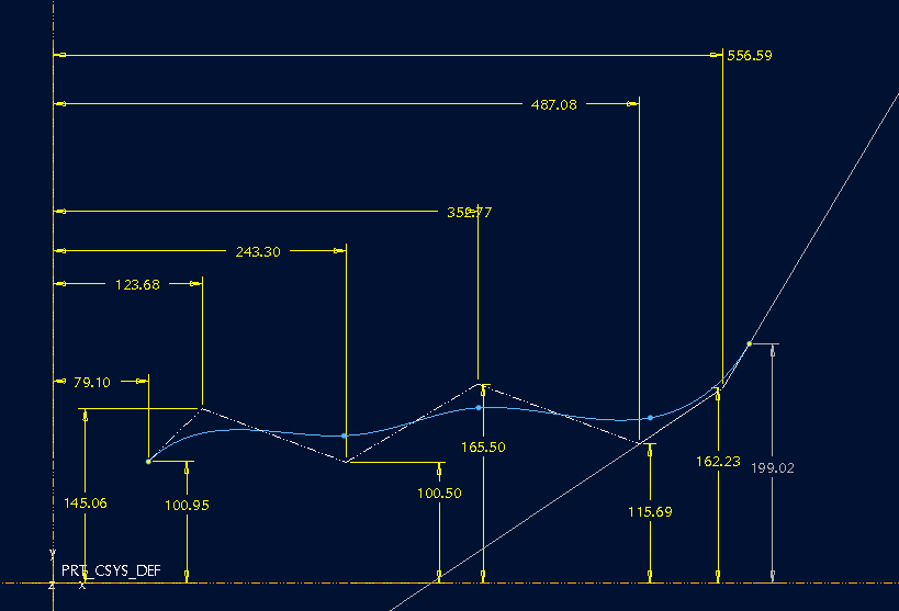

Aug 6, 2012 8:32 AM UTC
1-2) Isn't this already possible? If you double-click a spline you can switch from "interpolation points" to "control points"... You can check out the attached pictures; 4 different ways of dimensioning spline. You can change to a dimensioned spline, but not back again it seems...
Don't know for sure about 3-4. If I remember correctly, you can create a spline datum curve through points with curvature control at the endpoints, i.e. not use sketcher to create a curve. Or apply curvature constraints along edges in a blended surface, that attaches to other already existing surfaces.
/Mats Lindqvist/Econocap AB/Sweden/
Aug 6, 2012 4:22 PM UTC
Thanks. It get's tough to handle the splines with dimensions as the points constraint themselves with each dimension added so off hand it's possible to move multiple points only in one direction (either horizontal or vertical).
