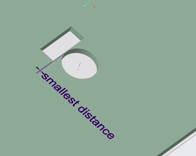

I have a doubt regarding how to calculate the smallest distance between edges using the toolkit. This is specifically for a sheet metal part.
Does anyone know how to accurately calculate the edge-to-edge distances or if there’s any workaround available for this? Any help or guidance would be greatly appreciated.
I've attached the image for your reference.

Hi @FabianWolf
I appreciate your response.
I was able to get the surface edges, but now I'm stuck trying to identify nearby edges. In the attached image, there is one rectangular and one circular extrude cut. I want to categorize them—such as identifying which edges belong to the rectangular cut and which to the circular cut—and determine if the edges of the rectangle and circle are closely located within the model.
If you know of any workaround or a better approach, please let me know. I've attached my code for your reference please take a look.

I assume your callback function contour_visit is called twice. First call for the contour of the rectangular and second call for the contour of the circular extrude.
I assume your EdgeVisitInputData is a struct that shall be used for gathering data. You can add a member like std::vector<ContourData> contours, that will gather all the edges for each contour. The type ContourData might hold a member int contour_id (optional) and an array like std:vector<ProModelitem> edges, that will hold all edges belonging to the corresponding contour.
Then you have all the edges separated into two lists. Now you can browse the lists via two nested for loops and calculate the distance for each edge out of first list and all the edges out of the second list. Provide a variable that memorizes the shortest distance until the loops are done.
To get the ProSelection input arguments for ProSelectionWithOptionsDistanceEval, use ProSelectionAlloc on basis of the ProModelitems representing the edges. I guess you are just doing this approach in the context of a sheetmetal part, so ProAsmcomppath is not relevant (set NULL).
