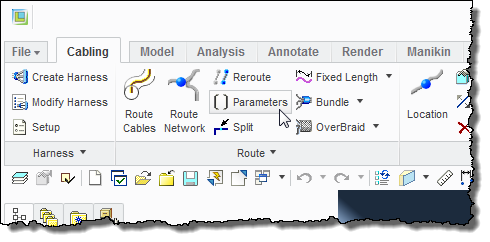

I am using Creo Parametric 2.0. My Harness Part has 30 wires and 3 spools.Let us consider
a) 10 wires belong to spool A
b) and next 10 Belongs to Spool B
c) and the third 10 belongs to Spool C.
by mistake while routing i did not change the spool name and routed all the 30 wire with Spool A. Now if i want to change the spools as per my requirement what is the solution?
I tried to go for reroute it will not help.
I tried route spool is showing but non editable please give me solution.

You should be able to simply edit the Parameters of your routed wires. Select Parameters from the Cabling menu (see below...)

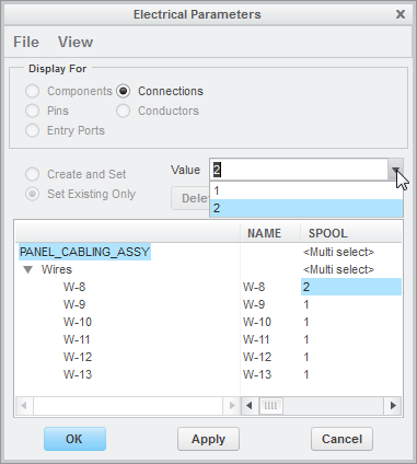

Next, select one or more wires or cables to edit. You can hold down the CTRL key to select multiple wires. Select OK and the parameter properties window will open. See below...
From here you can select the spool for each wire and make changes by selecting an alternate spool from the drop down menu.
You should easily be able to modify the spools for each of your wires this way.

Thank Brian, That was a great help and quick response with correct answers.
