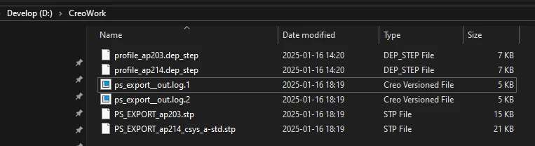

14.See Export Folder
15.Done
16.Run Finale
17.Done

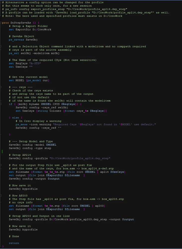

# Alternative a config option can be changed for the profile
# But this seems to work only once, for a new session
# ps_info config export_profiles_step "D:/CreoWork/profile_ap214.dep_step"
# A profile can be loaded with 'SaveObj load_profile "D:/CreoWork/profile_ap214.dep_step"' as well.
# Note: The here used and specified profiles must exists in D:/CreoWork
proc DoStepSaveAs {ExportDir MODEL} {
	# Setup a Export Folder
	set ConfigDir D:/CreoWork
	# SaveAs Object
	ps_saveas SaveObj
	# and a Selection Object command linked with a modelitem and no comppath required
	# csys is part of the acitve assembly
	ps_sel selObj -modelitem miObj
	# The Name of the required CSys (Not case sensitive)
	set ReqCsys "A-STD"
	set UseCsys ""
	# --- csys ---
	# Check if the csys exists
	# and setup the csys name to be part of the output
	# if not use the default
	# if the name is found the selObj will contain the modelitem
	if { [miObj byname $MODEL CSYS $ReqCsys]} {
		SaveObj config -csys_ref selObj
		set UseCsys [string tolower [format csys_%s $ReqCsys]]
	} else {
		# In Creo display a warning
		ps_mess -icon warning "Required Csys '$ReqCsys' not found in '$MODEL' use default."
		SaveObj config -csys_ref ""
	# --- Setup Model and Type
	SaveObj config -model $MODEL
	SaveObj config -type step
	# Setup AP214
	SaveObj config -profile [file join $ConfigDir profile_ap214.dep_step]
	# For the output Step file use _ap214 as post fix
	# and the name of the csys, for box.asm -> box_ap214_a-def.stp
	set filename [format %s_%s_%s [file root $MODEL ] ap214 $UseCsys]
	set output [file join $ExportDir $filename ]
	SaveObj config -output $output
	# Now save it
	SaveObj byprofile
	# Now AP203
	# The Step file has _ap214 as post fix, for box.asm -> box_ap203.stp
	# no csys info
	set filename [format %s_%s [file root $MODEL ] ap203]
	# Setup AP203 and Output in one line
	SaveObj config -profile [file join $ConfigDir profile_ap203.dep_step] -output $output
	# Now save it
	SaveObj byprofile
	#ps_mess "Csys Ignored on Export [SaveObj cget -csys_was_ignored ]"
	#ps_mess "Layer Setup was ignored [SaveObj cget -layer_setup_was ]"
	# Done
	return
# Just a test Call
# DoStepSaveAs [ps_model cur]

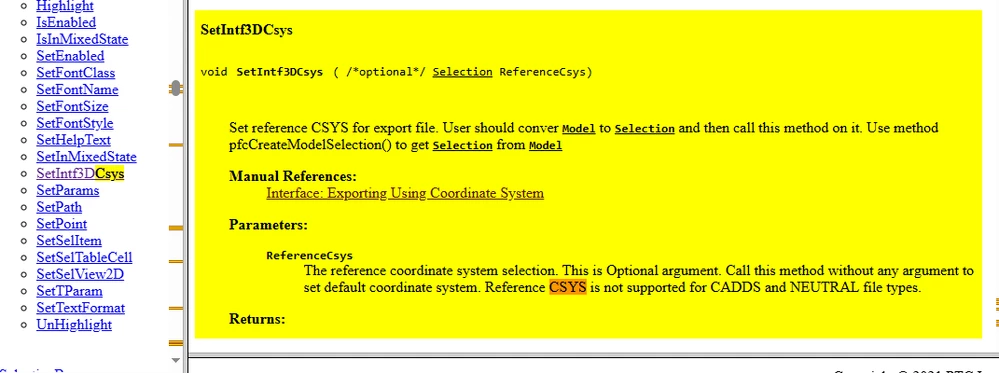

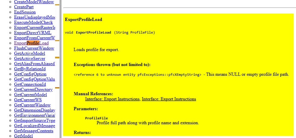

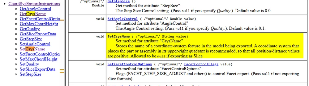

Jan 16, 2025 5:12 PM UTC
Hello Chris
A previous created and saved Profile can be loaded with ExportProfileLoad.SetIntProfile.png
There is a method mentioned to setup the csys: SetCsysName in CoordSysExport... and SetInt3DCsys.
This a a bit poor, but I guess you can specify the csys name in the export model.
Tcl Working Code to get an idea. This will export the active assembly with a specified csys and two different STEP API's
The exported data for ps_export.asm here:

This is good info, thank you. I created my tool in OTK Java Free (jlink) in the end, which did everything I needed. This will be valuable info for others though, I'm sure.
With regard to exporting parts with a different csys as the origin. I have found that to be quite unreliable, even when doing it manually through the UI, so I'd encourage anyone doing this in future to test that it works as expected in your use case before committing to it as a process.
	# SaveAs Object
	ps_saveas SaveObj
	set ReqCsys "A-STD"
	set UseCsys ""
	# --- csys ---
	} else {
	# Setup AP214
	# Now save it
	SaveObj byprofile
	# Now AP203
	# no csys info
	# Now save it
	SaveObj byprofile
	# Done
	return
