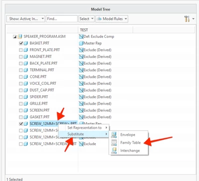

Not sure if there is a substitute call available in what you are doing... I would look for that first... because you can manually force that via the UI.

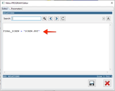

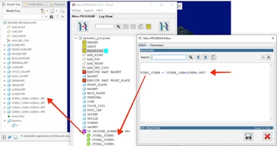

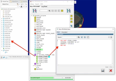

However, one quick way to be a bit more dynamic - would be to use Pro/PROGRAM to create a variable (parameter) for that location in your assembly structure.  This assumes a bit of a consistent process on your end, but works like a charm.
Then a simple parameter change should cause the replacement of the family table item at that location - assuming all the constraints are there for any dependent assembled/referenced components.
