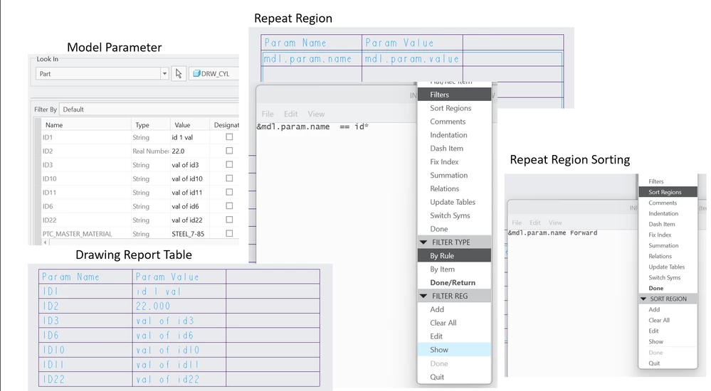

I have an identification table (1 row) that I insert into a drawing and it contains &ID1:D.
When I insert the table I get flagged with the 'ADD PARAM' menu.
From here I select string, type my new value, and &ID1 gets added as a parameter in my drawing.
I would like to be able to add a 2nd ID table that gets bumped to &ID2:D, so that on every table insert I get an additional parameter created in my drawing.
These id's can range to well over 100. So simply creating (2) different tables, one with ID1 and one with ID2, will not solve my problem.
Is this even possible?
Thanks for your help!

Yes I know, the request is &ID* (of the drawing) but I would recommend a report table for the attached model. and this is possible without programming, and Martin, please use 'As far "I" know it is not ... ' !
  1. Create a Table
  2. Add a simple Repeat Region (I used 2 columns, for the correct sort)
  3. As repeat data enter: mdl.param.name and mdl.param.value
  4. Add the filter &mdl.param.name == id*
  5. Sort by &mdl.param.name Forward (without it is sorting by creation order !, maybe you can sort mdl.param.value by mdl.param.name for the single column)
Now you onlyRepeat Model Parameter of ID*Repeat Model Parameter of ID* need to add a new parameter "ID*" in your model, and 'Voila' the table will report this.
