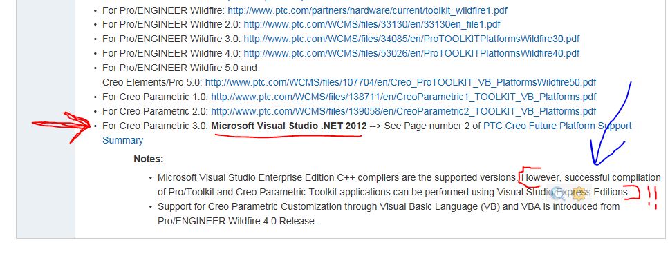

Toolkit compiling w/ Visual Studio Express
Anyone?  The PTC literature says it will compile.  Has anyone tried this with any success?
Nov 2, 2015 6:44 AM UTC
I can compile and unlock Creo 3.0 TK / OTK Licenses with VS 2012 Express. So I think it should work.
I only use the compiler out of it so we use VS 2015 Professional and inside use VS 2005 (WF 4.0), VS 2010 (Creo 2.0) and VS 2012 (Creo 3.0) compilers. I never had a problem with an express installation.

Oct 30, 2015 12:06 AM UTC
Hi all,
Mark, you would need to check if platform SDK ( I think 7.1) was available. SDK is a free download from Microsoft. I think Patrick wrote an extensive tutorial on this subject some time ago...
HIH.
Feliks.
